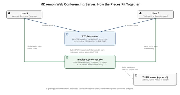

## The Moving Parts: RTCServer, STUN, and the Media Engine
Understanding what's actually running helps when something breaks. As explained in the [MDaemon product manual](https://help.mdaemon.com/mdaemon/en/web-conference-server.html), the feature is made up of two systems:
1. **RTCServer.exe,** the WebRTC signaling server. It uses Socket.IO, an open-source library for real-time, two-way communication between a browser and a server, to connect users, handle room chat, and negotiate sessions. This is the process that listens on the primary port, TCP 3443 by default.
2. **A Selective Forwarding Unit (SFU),** a media-server design where each participant uploads a single stream that the server simply forwards to everyone else in the room, rather than decoding, mixing, and re-encoding it the way an older-style MCU (Multipoint Control Unit) would. That makes an SFU far more scalable than either an MCU or a full mesh of direct connections between every participant. MDaemon's SFU is built on Mediasoup, an open-source WebRTC media library, and runs as the mediasoup-worker.exe process, which is what actually carries the audio, video, and screen sharing streams between participants.
A built-in STUN server, also part of RTCServer, helps clients find a reachable path to each other and to the SFU. STUN alone is enough for most networks. A TURN server, a relay server that both sides connect to when a direct or STUN-negotiated path isn't possible, is optional and only needed for the subset of connections that STUN can't traverse, typically users behind especially restrictive corporate firewalls or double NAT.
![mdaemon web conferencing architecture diagram](https://blog.mdaemon.com/hs-fs/hubfs/mdaemon-web-conferencing-architecture-diagram-large.png?width=620&height=328&name=mdaemon-web-conferencing-architecture-diagram-large.png)
The STUN server spins up one “worker” per CPU core, and each worker needs its own port. If your server has 4 cores and you've entered 2 IP addresses in the Web Conferencing settings, expect roughly 8 ports to be allocated. You don't have to guess at this: every time RTCServer starts, it logs the exact ports it assigned to the MDaemon-YYYY-MM-DD-RTCServer-Media.log file, in a line similar to this:
INFO | 4 STUN server workers initialized on ports: 10000, 10001, 10002, 10003
Use that log entry to confirm the real port range before you touch the firewall, rather than opening the entire default range (10000 to 11000) just to be safe.

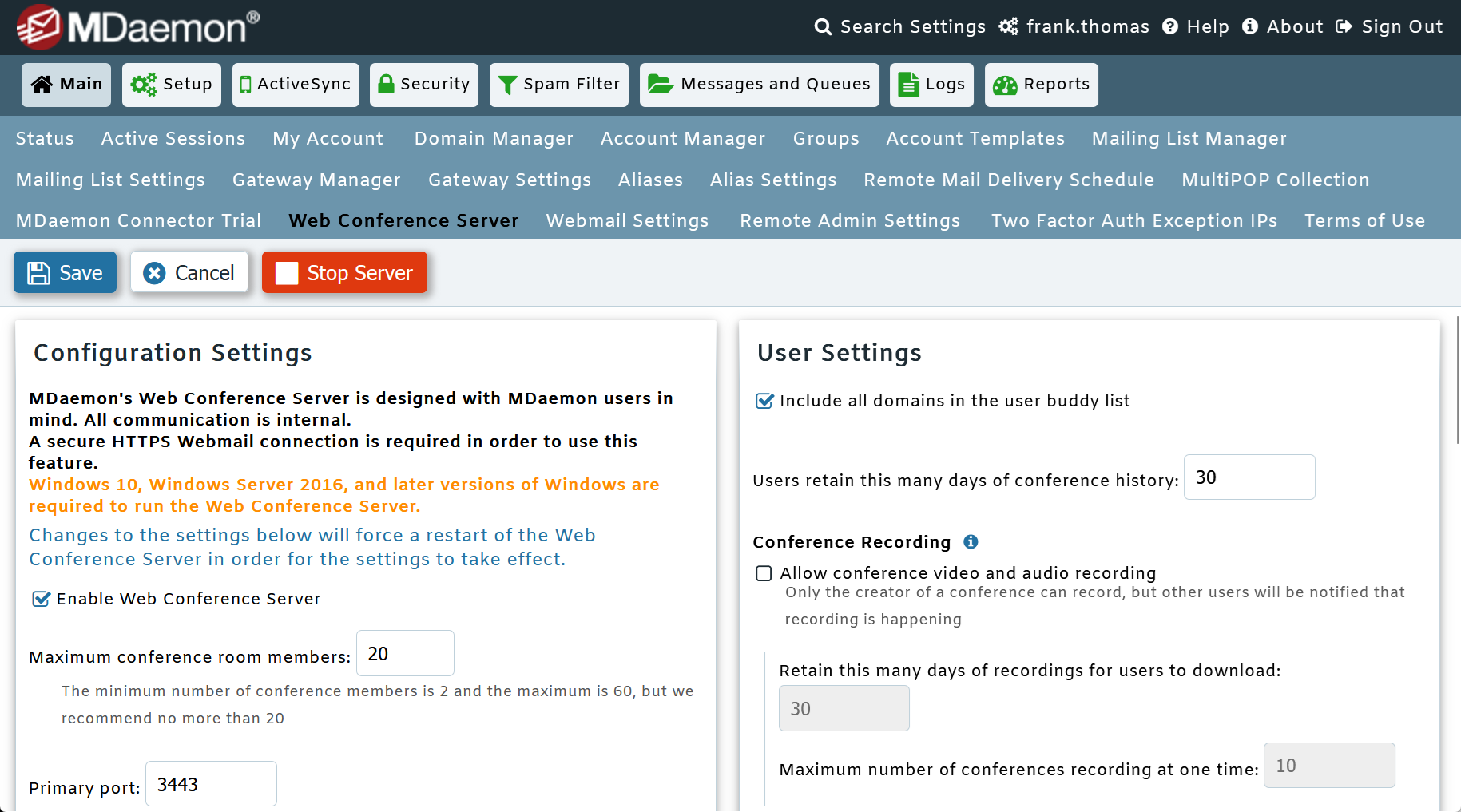

## Where to Configure It
Web Conferencing Server is configured entirely in MDaemon Remote Administration (MDRA), under Main | Web Conference Server. It does not have a configuration page in the desktop MDaemon Console.
From that page you can enable the service, set the primary port, enter your STUN Server IPs, define the STUN port range, set a maximum conference room size (2 to 60 participants, 20 recommended), enable the option to include all domains in a user's buddy list, and configure a TURN provider.
