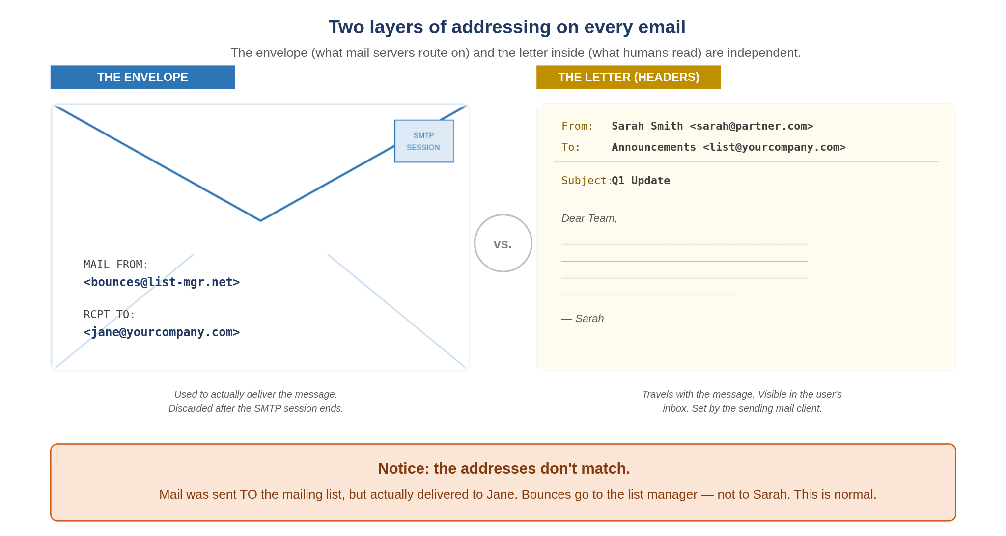

## The Postal Analogy
The easiest way to think about it is to picture a physical letter being mailed.
When you put a letter in the mail, there are really two layers of addressing:
1. **The envelope.** This is what the postal service uses to actually route the letter. The carrier never opens the envelope to read the letterhead inside; they look only at what’s written on the outside.
2. **The letter inside.** The letter might begin “Dear Mom,” and end “Love, Sarah.” That’s the human-readable salutation. It’s there for the reader, not the post office.
These can disagree. You can mail a letter that begins “Dear Mom” but is actually addressed on the envelope to your sister’s apartment so she can hand-deliver it. The post office doesn’t care what the letter says inside. It cares about the envelope.
SMTP works exactly the same way.
![SMTP Mail From vs. Envelope Address](https://blog.mdaemon.com/hs-fs/hubfs/diagram-1-envelope-vs-letter.png?width=2048&height=1092&name=diagram-1-envelope-vs-letter.png)
*Figure 1. The envelope (SMTP commands) and the letter (message headers) live on top of each other but mean different things.*

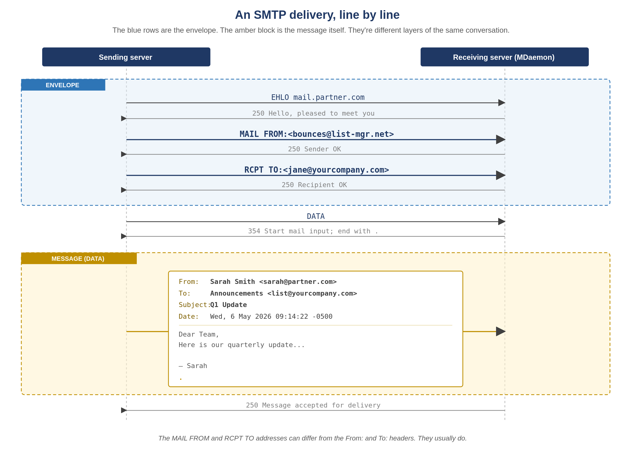

## What the Envelope Actually Is
When one mail server delivers a message to another, it doesn’t just hand over a file. It opens an SMTP session and exchanges a series of commands. Two of those commands are what we call the envelope:
- MAIL FROM:\<sender@example.com\> — the envelope sender, also called the “return-path.” This is where bounces and non-delivery reports go.
- RCPT TO:\<recipient@example.org\> — the envelope recipient. This is the address the receiving server will actually deliver the message to.
There can be multiple RCPT TO commands in a single SMTP session — one per recipient. Once those commands are accepted, the sending server issues the DATA command and transmits the actual message: headers and body together as one blob of text.
The envelope is what the SMTP servers care about. It’s how the mail gets delivered. And it is **not stored as part of the message** unless the receiving server chooses to record it.
## What the Message Headers Are
The message headers are everything inside the DATA portion of the SMTP transmission, above the blank line that separates the headers from the body. These include:
- From: — the human-readable author of the message
- To: — the displayed recipient
- Cc: — visible copy recipients
- Subject:, Date:, Message-ID:, and so on
One thing to keep in mind: **the message headers are written by the sending mail client, and the receiving server has no obligation to verify that they match the SMTP envelope at all.** A message can say To: board@example.com in its To: header but actually be delivered to fifty different RCPT TO addresses in the SMTP session. That’s not a bug. That’s how BCC works. That’s how mailing lists work. That’s how aliases work.
## Why They Often Disagree
Once you understand that the envelope and the headers are independent, a whole category of “weird” email behavior suddenly makes sense.
![SMTP Delivery Example](https://blog.mdaemon.com/hs-fs/hubfs/diagram-2-smtp-session.png?width=2048&height=1502&name=diagram-2-smtp-session.png)
*Figure 2. A complete SMTP delivery. The envelope rows determine routing; the message block is what the user reads.*

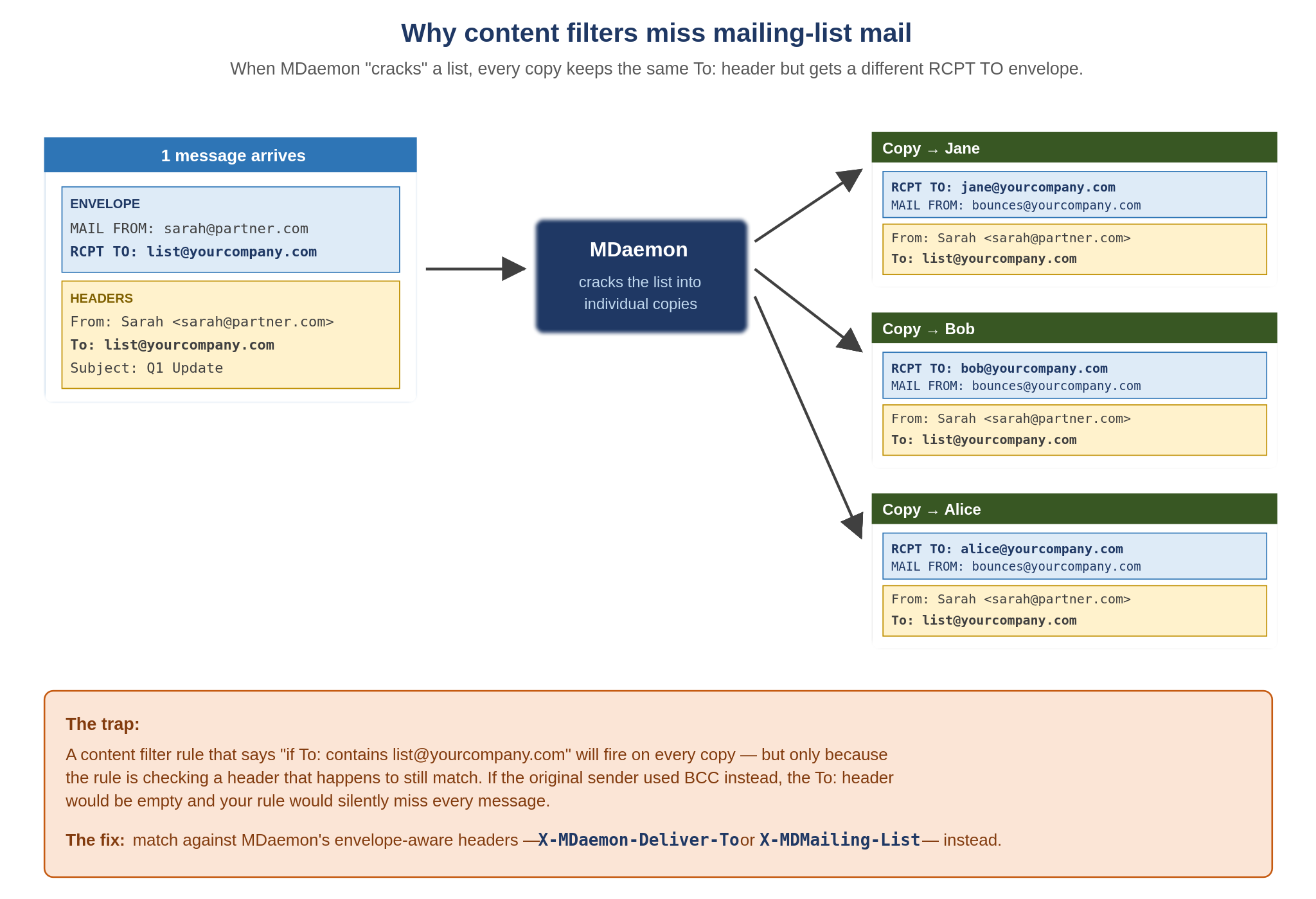

### Scenario 1: A content filter rule isn’t catching mailing list traffic
This one comes up often. An admin wants to filter every message sent to announcements@company.com. They write a content filter rule that matches when the To: header contains the list address. It works for some messages but mysteriously misses others.
![Why content filters miss mailing list mail](https://blog.mdaemon.com/hs-fs/hubfs/diagram-3-mailing-list-expansion.png?width=2048&height=1399&name=diagram-3-mailing-list-expansion.png)
*Figure 3. After list expansion, every copy carries the same To: header but a different RCPT TO envelope.*
What’s happening? The misses are almost always BCC’d messages or messages where the list was reached through an alias. The visible To: header doesn’t contain the list address — the address only existed in the RCPT TO envelope. The fix is to match against an MDaemon-generated header like X-MDaemon-Deliver-To or X-MDMailing-List, depending on whether the content filter is processing the message before or after MDaemon “cracks” the list into individual copies. The Mailing List Manager setting “Apply content & spam filters to list mail before cracking individual copies” controls which headers are available at filter time, and it’s the source of more confused tickets than almost anything else in this area. If that option is enabled, the per-recipient headers haven’t been added yet — your rule has to look at envelope-style information instead.

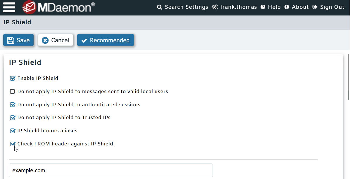

A phishing message arrives where the From: header displays a trusted name, but the SMTP envelope MAIL FROM is a throwaway domain at some far-flung host. The message technically authenticated against the envelope domain. The right defense is to enforce DMARC, which ties the two together, and to use MDaemon’s IP Shielding with the “Check FROM header address against IP Shield” option, which compares the visible From: to the connecting IP. Without understanding that the envelope and the header are different, none of those controls make sense.
![MDaemon-Email-From-Header](https://blog.mdaemon.com/hs-fs/hubfs/MDaemon-Email-From-Header.png?width=1197&height=613&name=MDaemon-Email-From-Header.png)
