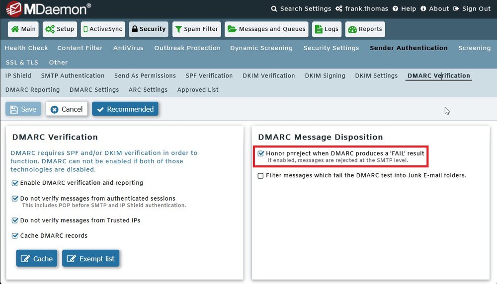

#### **2. The DMARC disposition settings have been changed from their defaults**
MDaemon's DMARC Verification screen includes a set of behavioral settings that determine what happens when a message fails DMARC and the sending domain has published a strict policy. These settings are enabled by default, meaning MDaemon honors a sending domain's published p=reject and p=quarantine policies out of the box. If failing mail is reaching inboxes when the sender's policy says otherwise, one possibility is that those settings were turned off, or weren't re-enabled after an upgrade or migration. Verify them at:
Security → Sender Authentication → DMARC Verification
![DMARC-P-Reject](https://blog.mdaemon.com/hs-fs/hubfs/DMARC-P-Reject.jpg?width=1000&height=572&name=DMARC-P-Reject.jpg)
Look for "Honor p=reject when DMARC produces a FAIL result" and "Filter messages which fail the DMARC test into Junk E-Mail folders." If either has been disabled, MDaemon will still evaluate DMARC and log the result, but won't take the corresponding action on the sender's published policy.

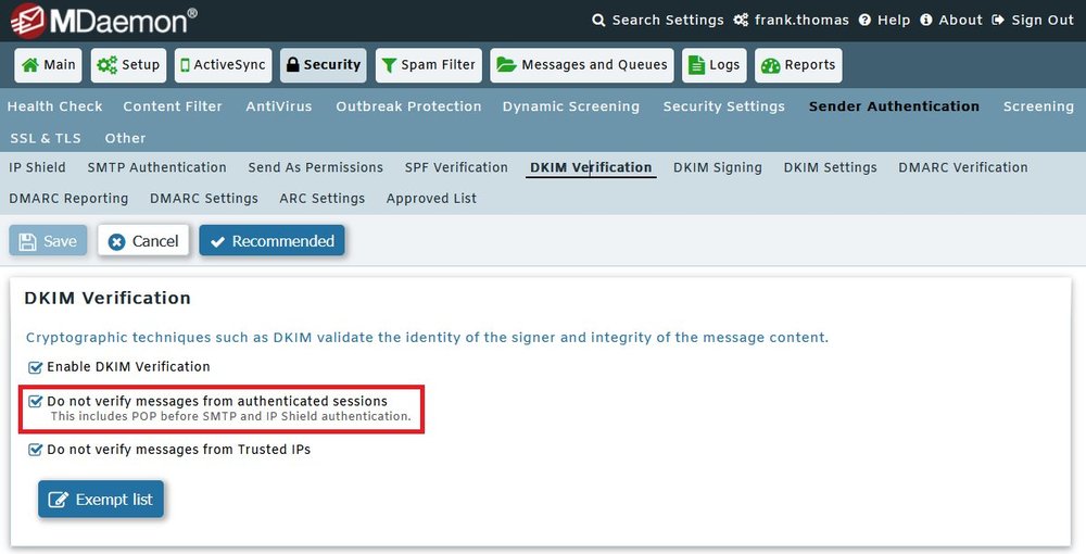

#### **3. DKIM Verification has its own Exempt list**
Most administrators audit Trusted Domains and Trusted IPs under Security Settings, but DKIM Verification has its own "Exempt list" button that does something similar. Any IP added there is exempt from cryptographic verification specifically — DKIM is skipped, and if SPF also doesn't conclusively fail, the message can pass DMARC by default. What can confuse some people is that this list isn't visible from the global Trusted IPs view, so a clean Trusted IPs audit can give a false sense of completeness.
Check: Security → Sender Authentication → DKIM Verification → Exempt list
![DKIM-Auth-Exemption](https://blog.mdaemon.com/hs-fs/hubfs/DKIM-Auth-Exemption.jpg?width=1000&height=510&name=DKIM-Auth-Exemption.jpg)
Audit this list periodically alongside your global Trusted IPs. Any IP listed here should have a documented reason, and stale entries should be removed.

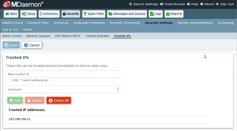

#### **4. The message came from a Trusted Domain or Trusted IP**
Trusted Domains and Trusted IPs are treated as if they were part of your own infrastructure. Authentication checks may be bypassed for these sources by design. The assumption is that anything coming from a trusted internal source has already been vetted.
Check: Security → Security Settings → Trusted Domains and Trusted IPs
![Trusted-IPs](https://blog.mdaemon.com/hs-fs/hubfs/Trusted-IPs.jpg?width=1000&height=555&name=Trusted-IPs.jpg)
 Watch out for any legacy entries: an old smarthost domain, a decommissioned relay's hostname, or a vendor IP that was added years ago and never removed. If any of those entries are ever compromised or reused, your authentication enforcement effectively has a hole punched through it.

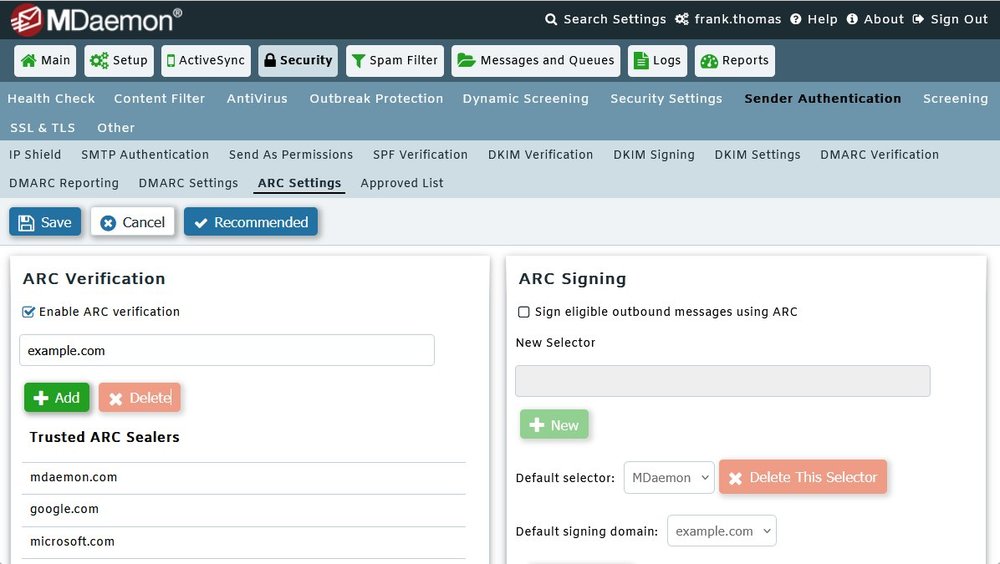

#### **5. ARC may be carrying forward an upstream "pass" (in environments that use it)**
This one only applies if your MDaemon is configured to trust ARC (Authenticated Received Chain) sealers. ARC ([more info from the Help file](https://help.mdaemon.com/MDaemon/en/security--arc_settings.html)) is designed to preserve authentication results through legitimate intermediaries — mailing lists, forwarders, secure email gateways — that often break SPF or DKIM by modifying messages in transit. When an upstream ARC-trusted host has vouched that the message *was* authenticated before it was modified, MDaemon can use that result during DMARC verification even though the message arrives at your edge looking like a failure.
If ARC isn't configured in your environment, this section likely doesn't apply. If it is, check: Security → Sender Authentication → ARC Settings
![Trusted-ARC-Sealers](https://blog.mdaemon.com/hs-fs/hubfs/Trusted-ARC-Sealers.jpg?width=1000&height=564&name=Trusted-ARC-Sealers.jpg)
Review your list of trusted ARC sealers. An unrecognized sealer, or a trusted one that has itself been compromised, could explain failures passing when they shouldn't.

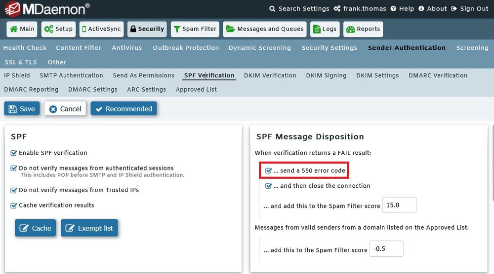

#### **6. Verification is happening, but the configured action isn't what you think**
MDaemon can verify SPF, DKIM, and DMARC and then, depending on configuration, log the result, tag the message in headers, add to its Spam Filter score, route it to a junk folder, or reject it outright during the SMTP session. Verification by itself doesn't dictate the outcome; the action does, and the action is configured separately on each Sender Authentication screen.
Check each tab under Security → Sender Authentication → SPF, DKIM Verification, and DMARC Verification. On SPF, look for the "When verification produces a FAIL result: ...send 550 error code" option. On DMARC Verification, look for "Honor p=reject when DMARC produces a FAIL result" and "Filter messages which fail the DMARC test into Junk E-Mail folders." DKIM Verification has no direct fail-action option of its own — failed DKIM influences DMARC alignment and Spam Filter scoring rather than acting on its own. But DKIM is still very important: DMARC alignment depends on a valid DKIM signature, so its enforcement happens downstream rather than on the DKIM Verification screen itself. If a screen is set to verify but the corresponding action you'd expect isn't configured, the delivery outcome may not match what the policy suggests it should be.
![SPF-550](https://blog.mdaemon.com/hs-fs/hubfs/SPF-550.jpg?width=1000&height=556&name=SPF-550.jpg)
